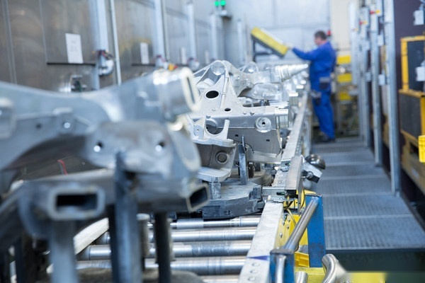

As a global metal processing specialist BENTELER offers its customers first-class engineering competence, innovative material and process technologies as well as expertise in metal forming and processing. (symbolic picture: production at a BENTELER Automotive plant)
